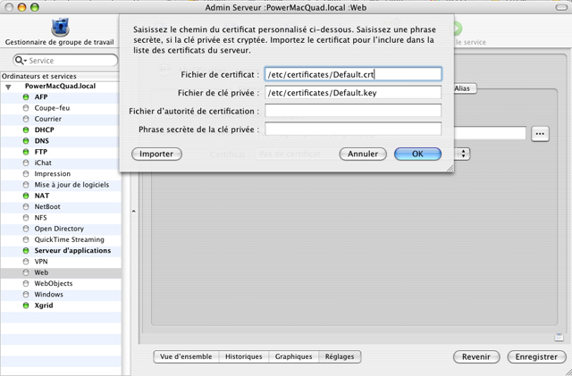

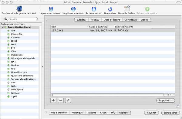

At this point I have two options :
first one is to use this /settings/certificates
the second one is to configure everything in /Web/Settings/General+Security/
Let see the first option.
I clicked on Import, a new window appeared and I entered my parameters :
Just after clicking Import it freezed for a long long time.
The password entered was : 123456. 4-Is that right?
I had to force to quit the Admin Server application to not wait for 3 days more!!

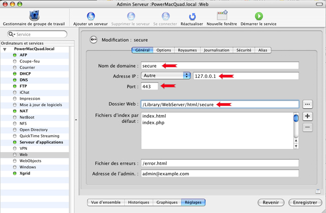

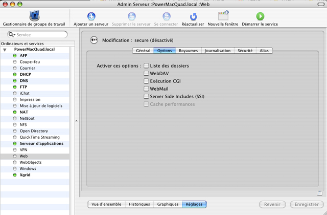

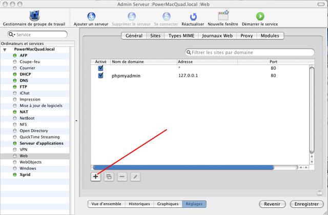

So now let see the second option :
I have only one ip.
On the first line there is my official website.
On the second it is the MySQL WebInterface : /Library/WebServer/Documents/phpMyAdmin/
Here I had to click on "+" to create a new Site.
You can see 4 arrows ponting some delicate points.
5-Are all these points ok? Are the parameters appropriated?

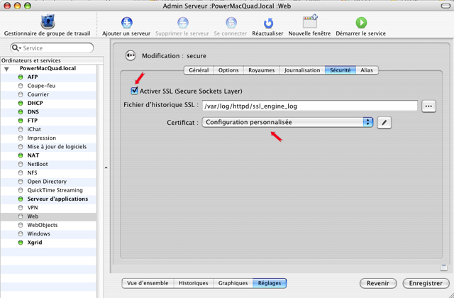

Now it is time to try to enter this #@!+$£#@& certificate.
First thing to do is to select personnalised configuration :
After that a question :

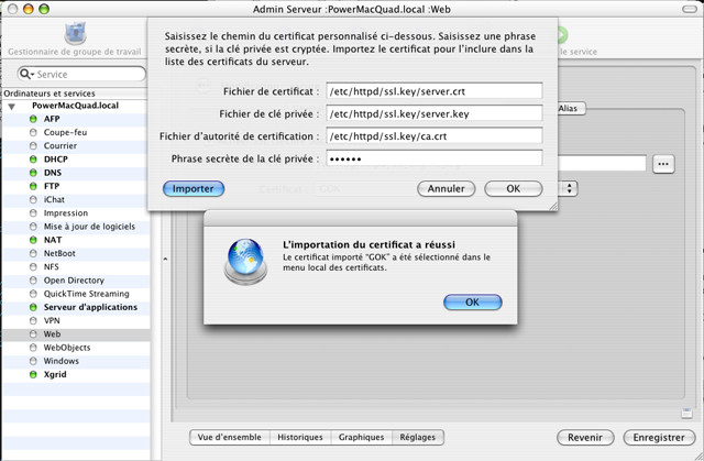

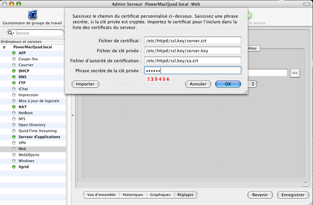

6-Why the default cert and key are stored in/etc/Certificates and not in the /etc/httpd/ssl.* like mine? Is that important?
I entered the parameters as it follows :
And that was good he said : Import successfull.
Now it is easy you click OK, then you save the new configuration.

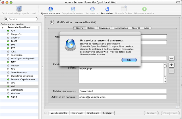

And when I want to restart the Web service, it fails like that :
Saying :
"try to reactualize configuration, try to contact admin, see the logs, impossible to restart".

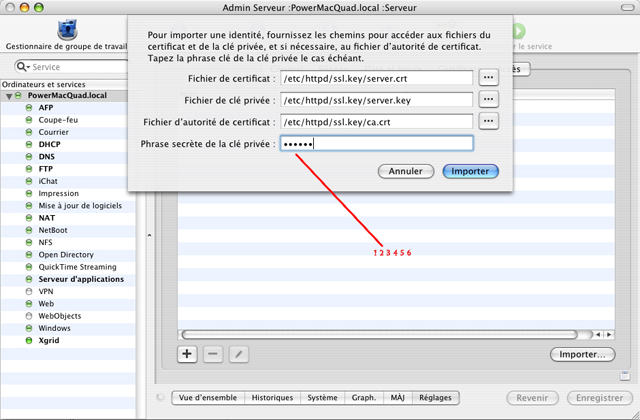

I have only one ip.
Saying :
