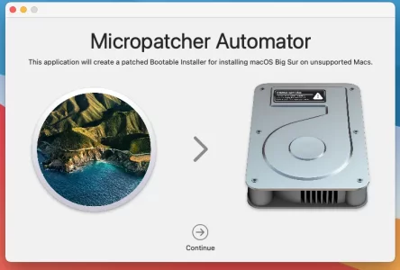

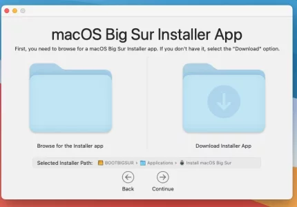

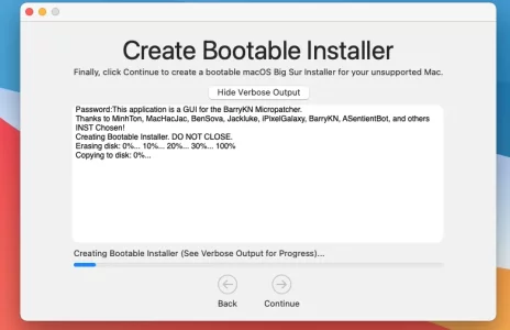

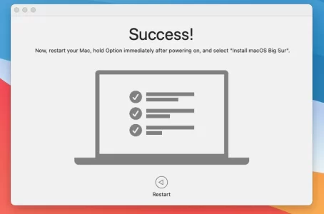

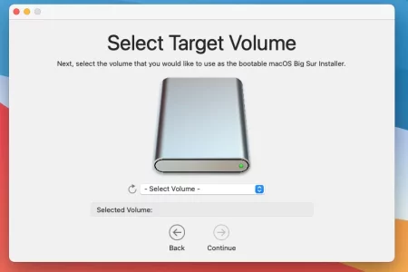

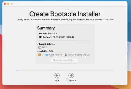

La création de la clef USB d'installation :
Capture d’écran 2021-02-18 à 10.20.07.png Capture d’écran 2021-02-18 à 10.21.09.png
Capture d’écran 2021-02-18 à 10.21.26.png Capture d’écran 2021-02-18 à 10.22.22.png
Capture d’écran 2021-02-18 à 10.23.49.png Capture d’écran 2021-02-18 à 10.46.56.png

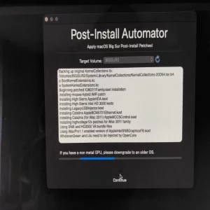

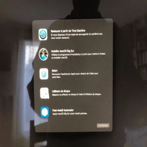

Après l'installation habituelle de Big Sur, voilà l'application des patchs :

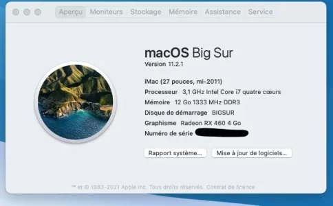

Et voilà, après l'installation habituelle, un iMac mi-2011 en Big Sur 11.2.1 :)

Voila la procédure :
  1. Download the latest release here: Download
  2. Format your USB drive as Mac OS Extended (Journaled) with GUID Partition Scheme using Disk Utility.
  3. Open the downloaded Disk Image and open MicropatcherAutomator.app
  4. Follow instructions in the application on how to create a bootable Big Sur USB for your unsupported Mac.
  5. When the process completes, press the Restart button to restart your Mac.
  6. Hold the Option key immediately after powering on your Mac, and select EFI Boot.
  7. In case the Mac stopped restart your Mac, then hold the Option key immediately, and select Install macOS Big Sur. Otherwise just select Install macOS Big Sur. You have got an OpenCore installation on your EFI Boot, see Notes below.
  8. Follow the instructions displayed on the screen to install macOS Big Sur.
  9. After installing macOS Big Sur, boot back to the USB.
  10. At the Utilities menu, select Post-Install Automator
  11. Follow the instructions in the app to apply post-install patches for your Mac to work properly.
  12. When complete, a dialog will appear. Press the Restart button to restart to complete your installation.
  13. If things do not work as intended try a PRAM or NVRAM reset.

Voila le résultat :)
