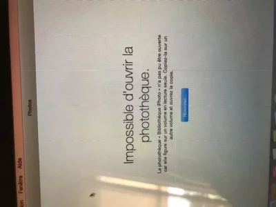

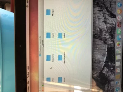

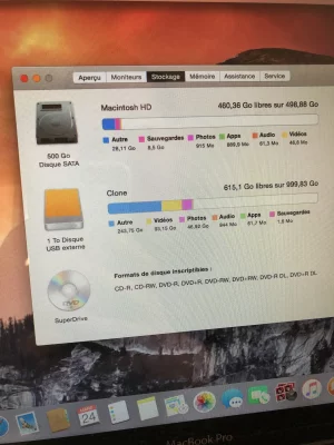

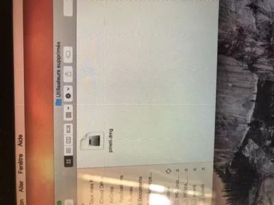

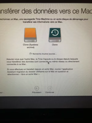

Merci mais je n y arrive pas il y a voici des images : peux tu encore m aider ? quand je vais sur utilisateur supprime il y les images suivantes ou je n ai d interdit dans les dossiers mais si je veux ouvrir photos j ai le message ci dessous
    36,5 KB · Affichages: 152
    33,9 KB · Affichages: 137
    30,3 KB · Affichages: 135
    32,8 KB · Affichages: 146
Étrange...
Ouvre le Finder > va au dossier Applications > Utilitaires > Terminal.

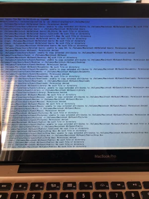

Passe la commande :
cp -av /Vol*/Clone/Users/* /Vol*/Macin*/
  • Qui clone tes documents du disque Clone sur la racine de ton disque
L'opération peut prendre du temps, attend le retour de MBPdechristelle:~ christellepinelli$ en signal de fin.
Poste le retour.

voilà :
Last login: Tue Mar 24 14:15:41 on ttys000
MBPdechristelle:~ christellepinelli$ cp -av /Vol*/Clone/Users/* /Vol*/Macin*/
cp: /Volumes/Macintosh HD/Deleted Users: Permission denied
cp: /Volumes/Clone/Users/Deleted Users: unable to copy extended attributes to /Volumes/Macintosh HD/Deleted Users: No such file or directory
/Volumes/Clone/Users/Deleted Users -> /Volumes/Macintosh HD/Deleted Users
cp: /Volumes/Macintosh HD/Deleted Users/.DS_Store: No such file or directory
cp: /Volumes/Macintosh HD/Deleted Users/.localized: No such file or directory
cp: /Volumes/Macintosh HD/Deleted Users/pinelli.dmg: No such file or directory
cp: utimes: /Volumes/Macintosh HD/Deleted Users: No such file or directory
cp: chown: /Volumes/Macintosh HD/Deleted Users: No such file or directory
cp: chmod: /Volumes/Macintosh HD/Deleted Users: No such file or directory
cp: chflags: /Volumes/Macintosh HD/Deleted Users: No such file or directory
cp: /Volumes/Clone/Users/Deleted Users: unable to copy ACL to /Volumes/Macintosh HD/Deleted Users: Permission denied
cp: /Volumes/Macintosh HD/Guest: Permission denied
cp: /Volumes/Clone/Users/Guest: unable to copy extended attributes to /Volumes/Macintosh HD/Guest: Permission denied
/Volumes/Clone/Users/Guest -> /Volumes/Macintosh HD/Guest
cp: /Volumes/Macintosh HD/Guest/Desktop: No such file or directory
cp: /Volumes/Clone/Users/Guest/Desktop: unable to copy extended attributes to /Volumes/Macintosh HD/Guest/Desktop: Permission denied
/Volumes/Clone/Users/Guest/Desktop -> /Volumes/Macintosh HD/Guest/Desktop
cp: /Volumes/Clone/Users/Guest/Desktop: Permission denied
cp: /Volumes/Macintosh HD/Guest/Documents: No such file or directory
cp: /Volumes/Clone/Users/Guest/Documents: unable to copy extended attributes to /Volumes/Macintosh HD/Guest/Documents: Permission denied
/Volumes/Clone/Users/Guest/Documents -> /Volumes/Macintosh HD/Guest/Documents
cp: /Volumes/Clone/Users/Guest/Documents: Permission denied
cp: /Volumes/Macintosh HD/Guest/Downloads: No such file or directory
cp: /Volumes/Clone/Users/Guest/Downloads: unable to copy extended attributes to /Volumes/Macintosh HD/Guest/Downloads: Permission denied
/Volumes/Clone/Users/Guest/Downloads -> /Volumes/Macintosh HD/Guest/Downloads
cp: /Volumes/Clone/Users/Guest/Downloads: Permission denied
cp: /Volumes/Macintosh HD/Guest/Library: No such file or directory
cp: /Volumes/Clone/Users/Guest/Library: unable to copy extended attributes to /Volumes/Macintosh HD/Guest/Library: Permission denied
/Volumes/Clone/Users/Guest/Library -> /Volumes/Macintosh HD/Guest/Library
cp: /Volumes/Clone/Users/Guest/Library: Permission denied
cp: /Volumes/Macintosh HD/Guest/Movies: No such file or directory
cp: /Volumes/Clone/Users/Guest/Movies: unable to copy extended attributes to /Volumes/Macintosh HD/Guest/Movies: Permission denied
/Volumes/Clone/Users/Guest/Movies -> /Volumes/Macintosh HD/Guest/Movies
cp: /Volumes/Clone/Users/Guest/Movies: Permission denied
cp: /Volumes/Macintosh HD/Guest/Music: No such file or directory
cp: /Volumes/Clone/Users/Guest/Music: unable to copy extended attributes to /Volumes/Macintosh HD/Guest/Music: Permission denied
/Volumes/Clone/Users/Guest/Music -> /Volumes/Macintosh HD/Guest/Music
cp: /Volumes/Clone/Users/Guest/Music: Permission denied
cp: /Volumes/Macintosh HD/Guest/Pictures: No such file or directory
cp: /Volumes/Clone/Users/Guest/Pictures: unable to copy extended attributes to /Volumes/Macintosh HD/Guest/Pictures: Permission denied
/Volumes/Clone/Users/Guest/Pictures -> /Volumes/Macintosh HD/Guest/Pictures
cp: /Volumes/Clone/Users/Guest/Pictures: Permission denied
cp: /Volumes/Macintosh HD/Guest/Public: No such file or directory
cp: /Volumes/Clone/Users/Guest/Public: unable to copy extended attributes to /Volumes/Macintosh HD/Guest/Public: No such file or directory
/Volumes/Clone/Users/Guest/Public -> /Volumes/Macintosh HD/Guest/Public
cp: /Volumes/Macintosh HD/Guest/Public/.localized: No such file or directory
cp: /Volumes/Macintosh HD/Guest/Public/Drop Box: No such file or directory
cp: /Volumes/Clone/Users/Guest/Public/Drop Box: unable to copy extended attributes to /Volumes/Macintosh HD/Guest/Public/Drop Box: Permission denied
/Volumes/Clone/Users/Guest/Public/Drop Box -> /Volumes/Macintosh HD/Guest/Public/Drop Box
cp: /Volumes/Clone/Users/Guest/Public/Drop Box: Permission denied
cp: utimes: /Volumes/Macintosh HD/Guest/Public: No such file or directory
cp: chown: /Volumes/Macintosh HD/Guest/Public: No such file or directory
cp: chmod: /Volumes/Macintosh HD/Guest/Public: No such file or directory
cp: chflags: /Volumes/Macintosh HD/Guest/Public: No such file or directory
cp: /Volumes/Clone/Users/Guest/Public: unable to copy ACL to /Volumes/Macintosh HD/Guest/Public: No such file or directory
cp: utimes: /Volumes/Macintosh HD/Guest: No such file or directory
cp: chown: /Volumes/Macintosh HD/Guest: No such file or directory
cp: chmod: /Volumes/Macintosh HD/Guest: No such file or directory
cp: chflags: /Volumes/Macintosh HD/Guest: No such file or directory
cp: /Volumes/Clone/Users/Guest: unable to copy ACL to /Volumes/Macintosh HD/Guest: Permission denied
cp: /Volumes/Macintosh HD/PINELLI: Permission denied
cp: /Volumes/Clone/Users/PINELLI: unable to copy extended attributes to /Volumes/Macintosh HD/PINELLI: Permission denied
/Volumes/Clone/Users/PINELLI -> /Volumes/Macintosh HD/PINELLI
cp: /Volumes/Clone/Users/PINELLI/.bash_history: Permission denied
cp: /Volumes/Clone/Users/PINELLI/.CFUserTextEncoding: Permission denied
cp: /Volumes/Macintosh HD/PINELLI/.cups: No such file or directory
cp: /Volumes/Clone/Users/PINELLI/.cups: unable to copy extended attributes to /Volumes/Macintosh HD/PINELLI/.cups: Permission denied
/Volumes/Clone/Users/PINELLI/.cups -> /Volumes/Macintosh HD/PINELLI/.cups
cp: /Volumes/Clone/Users/PINELLI/.cups: Permission denied
cp: /Volumes/Macintosh HD/PINELLI/.DS_Store: No such file or directory
cp: /Volumes/Macintosh HD/PINELLI/.Trash: No such file or directory
cp: /Volumes/Clone/Users/PINELLI/.Trash: unable to copy extended attributes to /Volumes/Macintosh HD/PINELLI/.Trash: Permission denied
/Volumes/Clone/Users/PINELLI/.Trash -> /Volumes/Macintosh HD/PINELLI/.Trash
cp: /Volumes/Clone/Users/PINELLI/.Trash: Permission denied
cp: /Volumes/Macintosh HD/PINELLI/Desktop: No such file or directory
cp: /Volumes/Clone/Users/PINELLI/Desktop: unable to copy extended attributes to /Volumes/Macintosh HD/PINELLI/Desktop: Permission denied
/Volumes/Clone/Users/PINELLI/Desktop -> /Volumes/Macintosh HD/PINELLI/Desktop
cp: /Volumes/Clone/Users/PINELLI/Desktop: Permission denied
cp: /Volumes/Macintosh HD/PINELLI/Documents: No such file or directory
cp: /Volumes/Clone/Users/PINELLI/Documents: unable to copy extended attributes to /Volumes/Macintosh HD/PINELLI/Documents: Permission denied
/Volumes/Clone/Users/PINELLI/Documents -> /Volumes/Macintosh HD/PINELLI/Documents
cp: /Volumes/Clone/Users/PINELLI/Documents: Permission denied
cp: /Volumes/Macintosh HD/PINELLI/Downloads: No such file or directory
cp: /Volumes/Clone/Users/PINELLI/Downloads: unable to copy extended attributes to /Volumes/Macintosh HD/PINELLI/Downloads: Permission denied
/Volumes/Clone/Users/PINELLI/Downloads -> /Volumes/Macintosh HD/PINELLI/Downloads
cp: /Volumes/Clone/Users/PINELLI/Downloads: Permission denied
cp: /Volumes/Macintosh HD/PINELLI/Library: No such file or directory
cp: /Volumes/Clone/Users/PINELLI/Library: unable to copy extended attributes to /Volumes/Macintosh HD/PINELLI/Library: Permission denied
/Volumes/Clone/Users/PINELLI/Library -> /Volumes/Macintosh HD/PINELLI/Library
cp: /Volumes/Clone/Users/PINELLI/Library: Permission denied
cp: /Volumes/Macintosh HD/PINELLI/Movies: No such file or directory
cp: /Volumes/Clone/Users/PINELLI/Movies: unable to copy extended attributes to /Volumes/Macintosh HD/PINELLI/Movies: Permission denied
/Volumes/Clone/Users/PINELLI/Movies -> /Volumes/Macintosh HD/PINELLI/Movies
cp: /Volumes/Clone/Users/PINELLI/Movies: Permission denied
cp: /Volumes/Macintosh HD/PINELLI/Music: No such file or directory

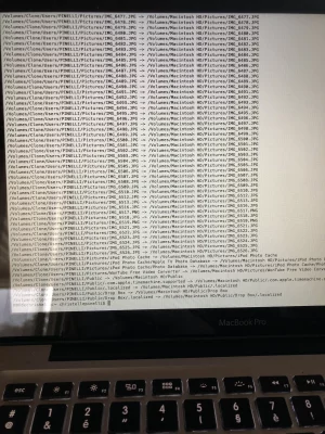

Passe la commande :
Poste le retour.

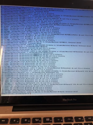

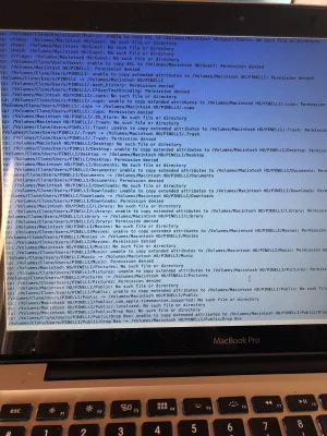

Pas possible de faire bloc de code car plus de 1000 caractères alors photos
    1,8 Mo · Affichages: 151
    1,5 Mo · Affichages: 132
    1,7 Mo · Affichages: 137

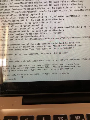

Coupe la commande en pressant Ctrl + C => j'avais oublier qu'il fallait précéder la commande d'un sudo...
- passe la commande :​
rm -r /Vol*/Macin*/PINELLI/ ; rm -r /Vol*/Macin*/Guest/
  • Qui supprime les fichiers "mal copiés" sur le disque interne.
(Pas besoin de poster le retour)

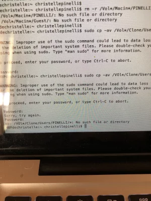

- repasse la bonne commande :​
sudo cp -av /Vol*/Clone/Users/PINELLI/* /Vol*/Macin*/
  • Tu devras marquer ton mot de passe à l'aveugle => celui que tu as attribué à ta session
Poste le retour.
Poste le retour.
Pour la 1ère commande :no Such file or directory
Alors passe juste la commande :
sudo cp -avn /Vol*/Clone/Users/PINELLI/* /Vol*/Macin*/
Poste le retour.
Tu dois marquer le mot de passe à l'aveugle => c'est à dire que tu ne vois pas les lettre que tu as marqué > mais ils ont bien étaient inscrite.
  • Haha
Réactions: christellep
Tu as marqué /VOL*/ au lieu de /Vol*/
- rererepasse la commande :hilarious: :​
Poste le retour.
  • Haha
Passe la commande (finale) :
open /Vol*/Macin*/
  • Cette commande ouvre une fenêtre du Finder de la racine du disque interne => ou ce trouve le dossier qui contient tes données
=> tu n'auras qu'à dire si le Finder s'est ouvert => le dossier qui contient tes données porte le nom : PINELLI
