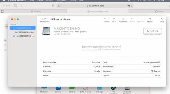

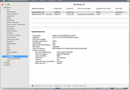

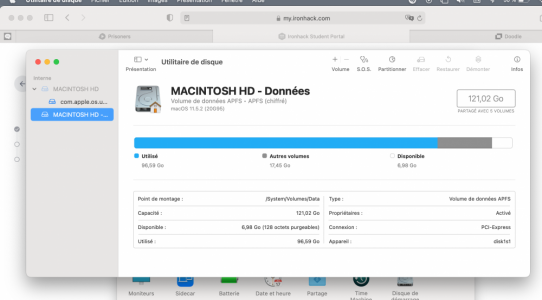

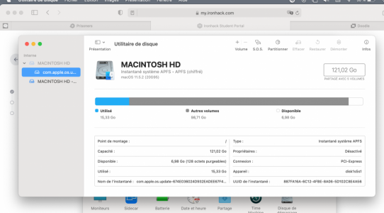

J'ai un peu le même soucis que tout le monde ici mais je vois qu'il est propre à chacun. Voici les captures ainsi que le résultat de la commande diskutil ap list.
diskutil ap list
APFS Container (1 found)
+-- Container disk1 4FF6ED58-2CC5-4695-B41A-0615FFB29B6B
    APFS Container Reference:     disk1
    Size (Capacity Ceiling):      121018208256 B (121.0 GB)
    Capacity In Use By Volumes:   114155438080 B (114.2 GB) (94.3% used)
    Capacity Not Allocated:       6862770176 B (6.9 GB) (5.7% free)
    +-< Physical Store disk0s2 9346589D-47E9-4EBF-80A3-B329871DAF15
    |   APFS Physical Store Disk:   disk0s2
    |   Size:                       121018208256 B (121.0 GB)
    +-> Volume disk1s1 612CF03E-5C95-449C-86F9-3CB9739B12CE
    |   APFS Volume Disk (Role):   disk1s1 (Data)
    |   Name:                      MACINTOSH HD - Données (Case-insensitive)
    |   Mount Point:               /System/Volumes/Data
    |   Capacity Consumed:         96706977792 B (96.7 GB)
    |   Sealed:                    No
    |   FileVault:                 Yes (Unlocked)
    +-> Volume disk1s2 0B427A85-4BE1-46A5-89E0-F45B8EE1F71B
    |   APFS Volume Disk (Role):   disk1s2 (Preboot)
    |   Name:                      Preboot (Case-insensitive)
    |   Mount Point:               /System/Volumes/Preboot
    |   Capacity Consumed:         285818880 B (285.8 MB)
    |   Sealed:                    No
    |   FileVault:                 No
    +-> Volume disk1s3 5DC98B35-4BB9-4B9D-8F3B-73C074E768C4
    |   APFS Volume Disk (Role):   disk1s3 (Recovery)
    |   Name:                      Recovery (Case-insensitive)
    |   Mount Point:               Not Mounted
    |   Capacity Consumed:         626241536 B (626.2 MB)
    |   Sealed:                    No
    |   FileVault:                 No
    +-> Volume disk1s4 C2E51D35-0B20-4C3F-9A61-D607315AFA0F
    |   APFS Volume Disk (Role):   disk1s4 (VM)
    |   Name:                      VM (Case-insensitive)
    |   Mount Point:               /System/Volumes/VM
    |   Capacity Consumed:         1073766400 B (1.1 GB)
    |   Sealed:                    No
    |   FileVault:                 No
    +-> Volume disk1s5 91F7E461-271B-4B15-A4A3-69B99E5884A3
        APFS Volume Disk (Role):   disk1s5 (System)
        Name:                      MACINTOSH HD (Case-insensitive)
        Capacity Consumed:         15332786176 B (15.3 GB)
        Sealed:                    Broken
        Encrypted:                 No
        Snapshot:                  887FA16A-6C12-4FBE-8A06-5D102C8E4A56
        Snapshot Disk:             disk1s5s1
        Snapshot Mount Point:      /
        Snapshot Sealed:           Yes

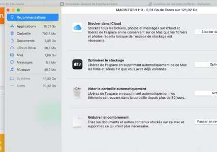

J'arrives pas a comprendre pourquoi j'ai seulement un stockage flash UTILISABLE de 121 Go alors que mon Mac détient un SSD de 256Go. Je te met une capture d'écran.
J'arrive pas à savoir ce que contient l'onglet "Autre" qui est rempli à hauteur de 79 Go en plus. Je ne peux cliquer dessus d'ailleurs.
"si tu as un problème --> ne serait-ce pas plutôt la minceur de l'espace libre restant dans le Conteneur apfs ? Car l'occupation globale du Conteneur est de 114 Go > ce qui ne laisse que 7 Go d'espace libre."
oui aussi ça le problème qui m'empêche d'installer une nouvelle version d'OS
Merci de ton aide
    596,6 KB · Affichages: 62

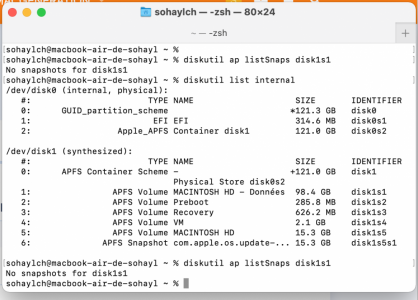

Ton SSD a une capacité physique de 121 Go. C'est ce qu'indique la table de partition GPT qui cartographie ses blocs -->
  • qu'est-ce qui te fait penser que ce SSD aurait eu une taille de 240 Go ?
Vu le peu d'espace libre actuel (qui proscrit même une réinstallation) --> il faut enquêter sur les 96,7 Go du volume-Données. Voir si on peut réduire cette occupation. Passe d'abord la commande (copier-coller) :
diskutil ap listSnaps disk1s1
  • qui liste d'éventuels instantanés rétenteurs d'espace disque qui seraient associés au volume-Données
Poste le retour.

- la partie haute du tableau décrit sous l'intitulé de disk0 (= 1er disque connecté) le disque matériel de ton Mac. Tu peux voir que sa capacité est de 121,3 Go et qu'il est divisé en 2 partitions primaires : une petite partition EFI de 314 Mo dédiée au programme interne de boot du Mac homonyme & une grande partition de 121 Go de type apfs.​
- la partie basse du tableau décrit sous l'intitulé de disk1 le Conteneur supporté par la partition apfs primaire du disque. Il s'agit d'un espace-disque virtuel hébergeant les 6 volumes de l'OS Monterey (ou Big Sur) - espace-disque virtuel qui n'a pas de réalité physique séparée de celle du disk0 matériel > mais qui a un simple statut de volume collectif par rapport à la partition apfs primaire.​
En résumé : ton SSD a bien une capacité physique de 121,3 Go et les 121 Go du Conteneur apfs ne désignent que la collection de volumes qui se trouvent montés sur la partition apfs du disque physique.

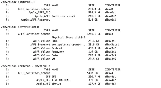

Capture d’écran 2022-07-12 à 22.25.39.pngCapture d’écran 2022-07-13 à 00.12.21.pngje dirais le disk1s1, mais je ne m'aventurerais pas à effacer le disk1s5 si tu ne me dis pas de le faire....

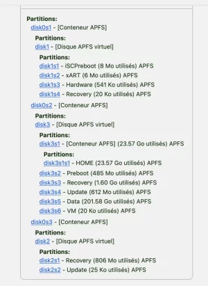

Je m'ismmisce ici pour prendre mon tour dans la file... Je viens de lancer un EtreCheck car mon disque interne est presque saturé quelques semaines à peine après l'achat d'un MacBook Pro refurbished. Puisque j'ai eu, moi aussi deux disques sur le bureau après avoir copié ma sauvegarde Time Machine (L'interlocuteur chez Apple m'en a fait effacer un par SOS Disque, sans aucunement avoir lancé le terminal...), je me demande si ma configuration est normale. Je vous mets en copie la page EtreCheck et la copie du Terminal.
Est-ce que cela vous semble OK... ou pas ? Merci de votre attention.
