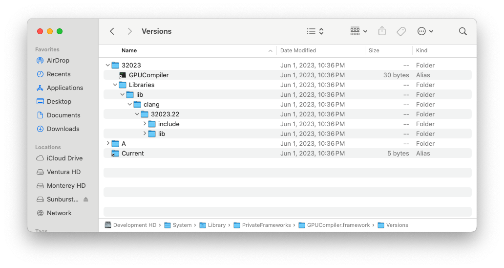

With macOS Sonoma, Apple has transitioned to a new LLVM compiler version known as 32023. This compiler is what powers the Metal graphics stack in macOS, and is critical to getting functional acceleration.
32023
However it seems this new compiler version hasn't changed the ABI drastically, as GPU's based off of the 31001 compiler are still mostly functional. Currently we've determined UI corruption within IOSurface, which would lead to incorrect rendering of wallpapers and menubar.

As mentioned in the 31001 section, Apple transitioned to a new LLVM version 32023. This has major implications with 3802 GPUs, as we're currently barely working with the Ventura release.
Specifically we're relying on 13.2.1's 31001 binaries to run, and as such 32023 will not be compatible with these GPUs.
At the time of writing, there has been no success at all with Sonoma, and we believe this will be our biggest challenge for support. Overall we're unsure if we can support these graphics cards.
